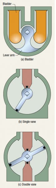

Fig. 2. cross-sections of bladder-, single-,  and double-vane-type rotary actuators.In a bladder actuator, Figure 2(a), the output shaft is driven by the expansion and contraction of a pair of bladders. When one bladder is pressurized, it pushes against a cup-shaped lever arm, rotating the shaft through an arc of up to 100°. A 4-way valve controls oil or air flow so that while one bladder is pressurized the other is exhausted.
Because this type of actuator has zero internal leakage, it is highly accurate, and insensitive to contamination. Almost any fluid medium can be used if the bladder is chemically compatible; special housing materials are not necessary. This actuator can transmit torque to 2,750 lb-in.
Another bladder design uses a rack-and-pinion mechanism driven back and forth by expanding and contracting air bags. The bags hold precharges indefinitely and provide rotation to 90° or 180°. Highest torque is at the beginning of the rotation cycle. Torques to 45,000 lb-in are possible.
A single-vane actuator, Fig. 2(b), has a cylindrical chamber in which a vane connected to a drive shaft rotates through an arc to 280°. Two ports are separated by a stationary barrier. Differential pressure applied across the vane rotates the drive shaft until the vane meets the barrier. Rotation is reversed by reversing pressure fluid at the inlet and outlet ports.
A double-vane actuator, Figure 2(c), has two diametrically opposed vanes and barriers. This construction provides twice the torque in the same space as a single-vane actuator, however, rotation is generally limited to 100°.
Vane actuators are easy to service because they have fewer parts and less-critical fits than many other types of rotary actuators. Their mechanical efficiencies range from 80% to 95%, depending on construction and application. The square corners of the vanes make sealing a challenge, and internal bypass leakage can be common in vane-type actuators. Position-holding may be limited without external controls. Vane-type actuators transmit torques to 700,000 lb-in.
