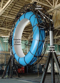

Figure 1. A simulated water slide built for Discovery Channel’s Prototype This program is approximately 30 feet in diameter and is pivoted and raised by hydraulic axes as it spins. The black boom extending into the center of the ring holds a projector that shows a video on the inside of the ring which is synchronized with five axes of motion.

In one of the show’s recent episodes, a computer projects an image of a water slide course inside a hollow fiberglass ring 30 ft in diameter, Figure 1. The rider and a small amount of water are inside the ring, so spinning the ring creates the sensation of moving through a water slide course. Raising and lowering the ring provides the G forces to simulate going over a waterfall, and tilting the ring from horizontal gives the impression of turning left or right. All that’s left, then, is to synchronize all this motion with a video presentation that’s projected on the inner surface of the ring, just ahead of the rider.
Hydraulics was selected to power the system because of the sheer mass of this machine. The ring itself weighs about 6000 lb, and lifting and tilting such a massive load smoothly and precisely with frequent and rapid changes in direction made hydraulics the best choice of power transmission. Electric motors could have been used to spin the ring, but because hydraulic cylinders were chosen to lift and tilt the ring, the design team chose instead to drive a friction wheel with a hydraulic motor to rotate the ring at speeds up to 10 rpm.

Two pairs of hydraulic cylinders provide the thrust and motion to raise and lower the ring and tilt it up to 15° from vertical as it rotates. Each cylinder is considered a motion axis because it must move in precise synchronization not only with the ride video, but with each other. Otherwise, cylinder forces could create stresses to break the framework apart.
A challenge to synchronizing the motion stems from two different cylinder mounting configurations used. The elevation cylinders work as a pair, so each must extend or retract the same distance within a tight tolerance. The cylinders that tilt the ring, on the other hand, have opposed mounting — as one extends the other retracts. This means the proportional valves feeding the two cylinders must open different amounts because one routes fluid to the rod end of a cylinder while the other routes fluid to the cap end of the other cylinder.
