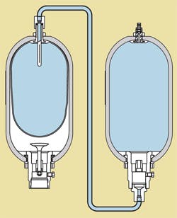

Gas bottles shrink size and cost
In situations where large accumulators are required, using gas bottles in conjunction with the accumulators can significantly reduce the cost of piston accumulators and gas bottles. Standard bladder accumulators are not recommended for use with backup gas bottles. This is because the small restriction in the valve stem assembly in a bladder accumulator presents the potential for the bladder to be extruded up into the gas stem, causing an immediate bladder failure. If gas bottles must be used with a bladder accumulator, a transfer barrier should be used, which provides a tube inside the bladder to prevent the bladder from being extruded into the gas stem.
However, a transfer barrier will restrict the flow rate from the accumulator to about 70 gpm. Capacity is also restricted with a transfer barrier because it can only be filled to 80% of its capacity. Plus, it must retain about 10% of the fluid inside when the system cycles. The result is a less efficient system. For example, a 15-gal transfer barrier can only be filled with about 12 gal of fluid. This would only provide about 10.8 gal of usable fluid from the unit when you consider that only about 90% of that fluid is available for work when cycling the units.
So assume that a 45-gal piston accumulator is required for an application. Further assume that the maximum and minimum system pressures are very close together (much like a die casting machine) where only 4.4-gal of fluid is required from the accumulator. If the working pressure ranges from 1700 to 2000 psi, a 44.48-gal accumulator would be required. The list price of a 45-gal accumulator is approximately $14,000. Using a 15-gal accumulator and two 15-gal gas bottles would reduce the accumulator cost by $5770. The added advantage is that gas bottles very seldom ever require any maintenance.
In addition to allowing the use of smaller accumulators to save money, gas bottles can save space. Gas bottles can be remotely mounted, laid on their side, or mounted in any orientation. So, instead of having to handle and use a very large accumulator that might weigh up to 2100 lb, using gas bottles will permit using a smaller accumulator, weighing less than 700 lb.
Additional cost savings can be gained in seal kits. Seal kits for a 50-gal accumulator can cost $1000 (depending on materials), whereas the seal kit for a 15-gal accumulator costs less than half that amount.

Figure 1. Gas bottles can be used in conjunction with accumulators when large capacity assemblies are required to significantly reduce the cost of the accumulators and gas bottles.
