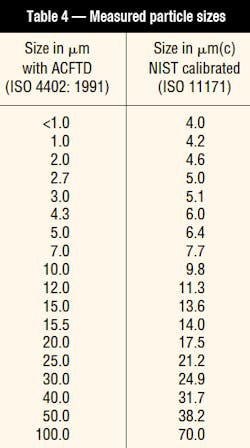

NIST certification and new calibration
The US National Institute of Standards and Technology (NIST) undertook a project to certify the particle-size distribution of ISO MTD suspensions in oil. From this study, the Institute determined that for particle sizes below 10 µm, the actual particle size is greater than previously measured using an automatic particle counter that was calibrated with ACFTD. Above 10 mm, the particles were smaller than under the old calibration system. To make a distinction, particle sizes based on the new NIST determination will be represented as X µm(c), with the (c) designation referring to certified calibration that has sizes traceable to NIST. Thus, particle size has a new definition, Table 1.

Table 1. Measured particle sizes
Size in µm
with ACFTD
(ISO 4402: 1991)
Size in µm(c)
NIST calibrated
(ISO 11171)
  4.0
1.0 4.2
2.0 4.6
2.7 5.0
3.0 5.1
4.3 6.0
5.0 6.4
7.0 7.7
10.0 9.8
12.0 11.3
15.0 13.6
15.5 14.0
20.0 17.5
25.0 21.2
30.0 24.9
40.0 31.7
50.0 38.2
100.0 70.0
