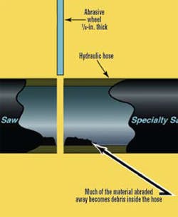

To understand this new method, let’s first examine the conventional method, which uses an abrasive wheel. Abrasive wheels cut a path equal to the thickness of the wheel and deposits most of that debris inside the hose being cut or up the exhaust chute, although a portion may be sucked away by an exhaust system. This method creates melted rubber, molten metal, and abrasive grit in the air which necessitates the exhaust system.
The abrasive wheel cuts using friction from grains of abrasive stone that come in contact with the hose materials and grind them away. As the abrasive grains become loaded up with melted rubber and steel, they break off and allow new sharp abrasive grains to be exposed and continue to melt more hose rubber and steel braiding. If the abrasive grains in the wheels are too fine, they load up after a few cuts, and the wheel starts cutting out of square. When the wheel becomes gummed up with melted rubber, it must either be replaced or cleaned. Both of these add substantial cost to the hose cutting process.
Conventional hose cutting techniques use an abrasive wheel that generates heat, smoke, and debris that can contaminate hydraulic systems.
