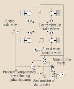

Schematic of mini-Baja’s hydraulic system shows configuration of key elements that, in combination, provide features and performance virtually unattainable with mechanical drives.
An alternator installed on the engine provides electrical power to operate the controllers and electrohydraulic valves that control the power delivered to each motor. The electrohydraulic valves allow four-wheel drive while turning without causing the front end to bounce or skip through the turn. This control, combined with articulated steering, provided an advantage in the maneuverability portion of the competition.

Simulation shows how hydrostatic dirve provides high acceleration in 4-wheel-drive mode or high speed in 2-wheel drive mode. Inset shows efficiency as a function of speed.
An ongoing project
Simulation has revealed especially useful information on vehicle speed vs. distance to check performance for the acceleration, top speed, and braking competition. It also provides key information on system efficiency vs. vehicle speed to ensure suitable performance over the operating range for the competition. Consequently, work on the vehicle is continuing to:
