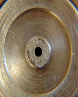

Because most valves have moving parts, we cycle components to ensure they will exhibit acceptable wear. Adhering to established standards are not enough when evaluating new materials or designs, We validate new designs through endurance testing. When we designed our new ERV3-10 proportional relief valves, endurance testing revealed a poor material and heat-treat selection for the relief valve seat, Figure 4. Detection of this failure resulted in an improved design, which would not have happened with only fatigue or burst testing. Endurance testing made the difference.
Endurance testing of of a prototype proportional relief valve revealed poor selection of material and heat treatment for its seat. Click on image for larger view.
