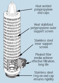

Figure 3. For applications where compressed air may have direct or incidental contact with food, beverages, or their packaging, filters with pleated PTFEelements should be specified to minimize potential product contamination.The oil-free alternative

Whether a food processing plant uses lubricated or oil free compressors, proper filtration is still required to ensure that clean air is supplied to the process equipment. Specialized filters — such as activated carbon filters or PTFE-impregnated depth or membrane surface filters — are also required as part of the in-line filtration package. PTFE filters use non-shedding, hydrophobic filter elements to eliminate bacterial contamination in the compressed air stream. These filters, Figure 3, must be cleaned with steam to ensure their continued effectiveness. PTFE filters meet FDA requirements of CFR Title 21 if clean, dry compressed air is supplied to them. Therefore, pre-filtration for these filters is essential in meeting FDA requirements, Figure 4.
