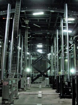

Taking in Franco Dragone’s The House of Dancing Water production in Macau, China’s City of Dreams, is breathtaking. Sophisticated staging is actually composed of eight different lift sections. The stage (Fig. 1) sits atop a forest of hydraulic cylinders (Fig. 2) that lift and lower the sections up to  27 ft. in the world’s largest indoor swimming pool. At times the lifts are raised to form a dry stage and at other times, they independently recede to produce a water pool for swimmers, only to emerge again carrying large props such as a pagoda structure (Fig. 3) and a 26-ton ship (Fig. 4).
The cylinders are controlled by a bank of 11 RMC150 electrohydraulic motion controllers (Fig. 5) manufactured by Delta Computer Systems. Four hydraulic cylinders (mounted symmetrically underneath) actuate each main platform section—for a grand total of 32 motion axes controlling the main platform sections. Another 18 axes operate three performers’ entry and exit ramps (each ramp, called a vomitorium, has six axes of control for lift, extension, and tilt). All main platform cylinders are controlled by remote valve manifolds located in the basement of the theater beneath the pool, and the cylinders are mounted to the pool floor inside submerged concrete caissons.

2. Here is a view of the hydraulic cylinders in the empty pool under the stage. The LMDT rods are visible next to the cylinder rods.
Each cylinder has an 8-in. bore with a 7-in. rod and a 324.8-in. (27 ft.) stroke. The cylinders are fed by Parker servo-quality proportional valves. To provide a measure of its position, each cylinder is instrumented with a 27-ft. long magnetostrictive linear displacement transducer from MTS Sensors. Hydraulic fluid to operate the system is pumped from a 3,500-gal reservoir by 21 Parker PV variable-displacement piston pumps and T7 fixed-displacement vane pumps. In total, the pumps can deliver up to 1,671 gpm of pressurized fluid. The pumps are driven by seven electric motors that can transmit up to 2,100 hp.

The motion controllers receive cylinder position feedback from the magnetostrictive linear displacement transducers (LDTs) that are mounted inverted alongside the cylinder bodies, with the controls on the rod side and the sensing probe extending down toward the cap of the cylinder. This orientation allows easier removal and repair or replacement than if they were mounted inside the cylinders. A stainless-steel rod and magnet carrier is attached to the cylinder’s rod clevis that carries the magnet up and down the sensing element of the probe pressure tube. The LDTs, each situated in a watertight housing, interface to the RMCs in the dry area under the pool via synchronous serial interface using waterproof cabling, seal glands, and connectors.
