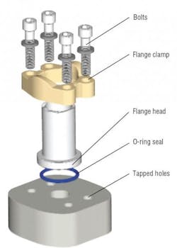

The 4-bolt flange port connection consists of four primary components: flange head, O-ring, flange clamp (captive or split) and four bolts. The port is simply a flow passage surrounded by four tapped holes that accept the clamping bolts. Typically, the flat-machined surface of the port compresses the O-ring contained in the groove of the flange head when the bolts are tightened. The bolts, placed through the flange clamp, squeeze on the flange head, compressing the O-ring in the groove leaving no leak path or possibility of O-ring extrusion, Figure 1.
Figure 1 — Typical four-bolt flange port connection components.
