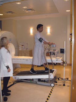

A special treadmill, designed to operate in a room with an MRI machined, relies on water hydraulics for its power.
When you go to a hospital or clinic, you expect everything to be not just clean, but spotless. Therefore, you might think we use tap water in the hydraulic system of treadmills that operate in magnetic resonance imaging (MRI) facilities because tap water is clean, so any incidental spills or leaks would be of little consequence. That’s true; when it comes to environmental friendliness, it’s hard to beat plain old water. But that’s not why we use it.
We use fluid power because MRIs in clinical use generate powerful magnetic fields — typically 1.5 to 3 Tesla. Consequently, anything attracted by magnetic fields could be pulled toward the MRI’s magnets. Furthermore, anything that can produce magnetic fields — such as electrical current flow — can interfere with the MRI itself. Therefore, the treadmill cannot contain any ferromagnetic materials or electrical components and must use non-conductive hoses and other components.
Obviously, we couldn’t use electric motors or solenoids in the treadmill. That left us with a choice between hydraulics or pneumatics. Pneumatics was briefly considered, but issues with compliance (compressibility) and noise seemed too significant to overcome within application parameters. Therefore, hydraulics became the obvious choice. But hydraulic motors are usually made of ferrous metals, so those were ruled out. We then focused on stainless steel hydraulic motors and found that those that fit our application parameters were designed to use water as the hydraulic fluid.

Initial prototype testing began outside an MRI room to match performance to established speed and gradient combinations. We expected belt speed and elevation to stabilize within ± 5% of required values. Sensors and software interlocks also included component maximum speed limits and other safety concerns.
Testing was conducted to ensure that the MRI environment did not influence the operation of the treadmill and controls and that the components of the treadmill could be safely located within the MRI’s magnetic field. A 0.7 Tesla permanent magnet was used to test all individual components of the treadmill for magnetic attraction. The completed treadmill assembly was also tested for magnetic attraction.
Additionally, we tested the machine to ensure it would not influence the quality of images recorded during diagnostic tests. A series of standardized tests was conducted to measure image quality comparing the image quality with no treadmill in the MRI room, to a fully connected, stationary treadmill located close to the magnet, and, finally, to an operating treadmill.

The initial treadmill prototype served its intended function by meeting performance goals and providing a platform suitable for clinical research on a limited scale. Many minor changes to hardware and software were required to meet specifications and provide reliability.
Based on the success of the initial prototype, a next generation treadmill design has been built to conduct a multicenter clinical trial. Attention to details of clinical ergonomics, software convenience, enhanced performance, and improved serviceability were incorporated into the new design.
