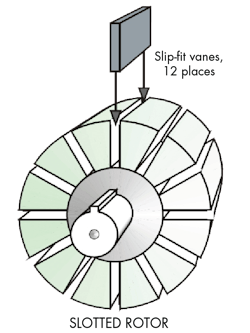

3. Inserting a vane into each rotor slot builds the rotating group of a vane pump.
The vane pump’s moving parts consist of a slotted rotor into which rectangular vanes are inserted, one vane for each of the slots (Fig. 3). Clearances between the vanes and slots are such that a compromise is made between having the vanes freely sliding within the slots and forming a fairly high impedance (low internal leakage) path between the high- and low-pressure sides. The pump design in Figure 3 has 12 vanes, but any even or odd number of vanes can be used.

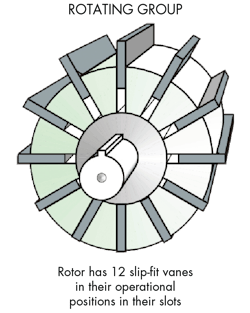

4. The vane pump’s rotor has all vanes in position so that the rotating group can be inserted into the cam ring.
Figure 4 shows all of the vanes inserted into the rotor and the rotor assembly inserted into its cam ring. The sliding fit between the rotor slots and the vanes ensures that the vanes can move outward from centrifugal force to make positive contact with the inner periphery of the cam ring. The cam ring constrains the outward (radial) motion of the vanes while the eccentricity between it and the rotor’s center of rotation controls the pump’s displacement.

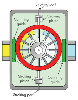

7. Stroking pistons plus external access through hydraulic ports allow the cam ring and displacement to be varied.
Now, though, the need arises for some external means of changing the cam-ring position so that pump output can be changed at will, or changed automatically using feedback. The stroking pistons shown in Figure 7 provide that capability.
External ports allow hydraulic access to the pistons, usually with an electrohydraulic servo or proportional valve. Electrohydraulic stroking is done by closing the loop on the cam-ring position with a position transducer, most often with a linear variable differential transformer (LVDT), not shown in Figure 7. Cam-ring guides (dark green) prevent its right-left movement.

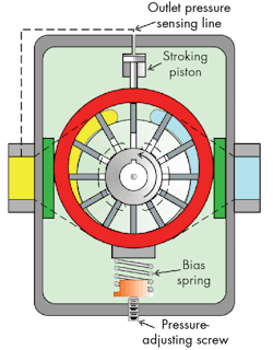

Pressure compensation in the variable-displacement pump is easily achieved via hydraulic methods. Pressure compensation equips the pump with internal feedback that automatically reduces displacement if a threshold pressure is exceeded.
In fact, pressure-compensation pumps can be safely deadheaded; that is, the output port can be totally blocked without damaging the pump. One way to achieve pressure compensation of the vane pump is shown in Figure 8.
8. Pressure compensation can be achieved by connecting the stroking piston port to the outlet pressure and replacing the lower stroking piston with an adjustable bias spring.
Here, the lower stroking piston has been replaced by a bias spring with a pre-compression adjusting screw. The upper stroking piston’s hydraulic port is connected to the outlet pressure so that the piston “senses” the outlet pressure. The bias-spring pre-compression causes an upward force on the cam ring, forcing the cam ring into the position shown when the outlet pressure is low. Under this operating condition, the pump operates like a fixed-displacement pump at max displacement and max output flow.
As the load pressure builds, the stroking piston exerts an increasing force on the top of the cam ring. At some point, the stroking piston force exceeds the pre-compression force of the spring, which automatically decreases the displacement. Blocked port pressure and deadhead pressure mean the same thing, i.e., the pressure at the outlet port under the condition of zero output flow. It is analogous to the Thevenin voltage of an electrical generator or other voltage source.
