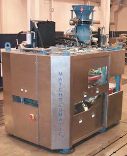

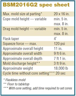

Today, Beardsley & Piper LLC, is part of the Simpson Group owned by Simpson Technologies Corp., Aurora, Ill. Beardsley & Piper developed the BSM2016G2 Series Matchblomatic, an automatic matchplate molding machine that produces ready-to-pour flaskless green sand molds. One machine is said to offer the productivity of three to five industry-standard jolt-squeeze molders and requires only slightly more space than a single jolt-squeeze machine. The first-generation Matchblomatic was the first matchplate machine to use a blow-squeeze molding method to produce uniform high-quality molds. The BSM2016G2 produces up to 180 molds per hour with the precision of a machine tool, thanks to a simplified design.

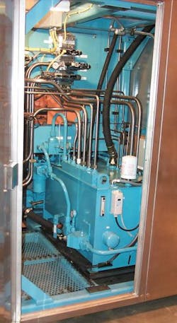

The matchplate molding machine has a custom-made HPU powered by a 30-hp, 1800-rpm electric motor driving a 42-gpm hydraulic pump with horsepower limiting control. Click on image for larger view.
According to Boris Shiller, Beardsley & Piper engineering manager, more than 500 of the earlier designs of the Matchblomatic are still in use today in all types of foundries around the world. The new Matchblomatic Series features a semi-enclosed design, independently variable cope and drag height, an updated proportional control system, quick change pattern features, automatically adjustable blow pressure, larger volume sand magazine, a butterfly valve sand gate, an automatic spray pattern, and a fully updated control and operator interface scheme.
The machine's hydraulic system was designed and built by Flodyne/Hydradyne Inc., a Bosch Rexroth distributor, system designer, and integrator located in Hanover Park, Ill. The hydraulic system includes a custom hydraulic power unit (HPU) incorporating an 80-gal reservoir and Bosch Rexroth 42-gpm maximum horsepower-limiting pump driven by a 30-hp, 1800-rpm electric motor. The high-pressure portion of the duty cycle is 3000 psi.
The pump was  selected for its high efficiency, low noise, and reliability. Its horsepower-limiting option greatly reduced the size of the electric motor needed. Furthermore, it allows for a low-pressure standby operation of the machine to further consere energy.
Also included are three loose valve assemblies, which incorporate four Rexroth proportional valves, plus various other valves. Selection of these components was based on the recommendations of Flodyne/Hydradyne and Bosch Rexroth after they thoroughly reviewed Beardsley & Piper's design and performance requirements.

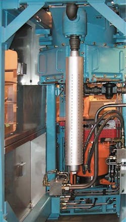

A custom hydraulic power unit’s pump reduced the size of the electric motor required, while allowing for a low-pressure standby mode for the machine. Click on image for larger view.

The digital servodrive produces a fast, controlled squeeze, which decreases the cycle time of the machine and increases mold output. It also eliminates mold pattern breakout by closely matching both cope and table squeeze forces and providing a menu-based automatic adjustment of pressures, forces, and hydraulic actuator velocities, as well as positions for the various patterns users might need. This automatic setup eliminates the need for manual adjustment of the machine, resulting in quicker and repeatable parameter changeover.

Beardsley & Piper uses another Rexroth digital servodrive on the drag flask, which provides fine control of position, while allowing a smooth force override on the position of the drag flask hydraulic actuator during squeeze. This servodrive optimizes the hydraulic axis for analog position, pressure, or force control. All card settings can be accessed with onboard pushbuttons and a digital display, and users can perform application configuration and commissioning. This includes the correct mechanical, hydraulic, and electrical installation.Simpson Technologies sold the Matchblomatic product line to Roberts Sinto Corp. in 2008. Click here for information on Roberts Sinto's Matchblomatic machines.
