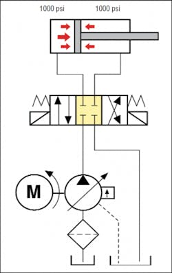

A component manufacturer was experiencing problems with an automatic production machine. While the hydraulic system was idle (pump running) the piston rod (horizontal mount) on a transfer unit cylinder was creeping out and disrupting the cycle. As a result, the operator had to constantly select the manual override position and reset the machine. This created an unacceptable loss of production time. Maintenance personnel tried everything they could think of to correct the situation, including replacing the cylinder and the directional control valve.

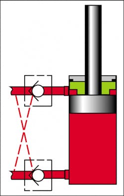

They asked their local fluid power distributor for any suggestions. The distributor’s sales technician reviewed the problem and advised them to add a pilot-operated check valve at the cylinder’s rod-end port. This suggestion did not solve the problem, and the cylinder continued to creep.
They finally asked for assistance from one of the company’s engineers. It turned out that the directional control valve was misapplied. When a pressure-compensated pump is used in conjunction with a single-rod, double-acting cylinder, there are a few items that need to be taken into consideration:
• rod-to-bore ratio,
• whether or not the cylinder rod is under constant load,
• compensation pressure setting, and
• duration of cylinder idle time.
When the pressure at the inlet port of a directional control valve is constant, the oil will leak across the spool, and the pressure will equalize on both sides of the cylinder piston. However, because the areas on both sides of the piston are unequal (due to the rod), the force tending to extend the piston rod is greater that tending to retract it. The net result: the cylinder creeps, Figure 5.
The original directional control valve had a closed center spool configuration — this was incorrect. The problem was rectified by installing a valve with a float-center configuration, along with a pilot-operated check valve.
