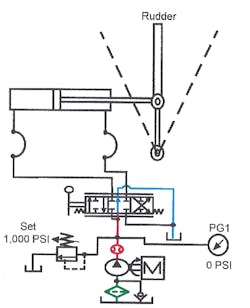

Feedback to a stepper-motor-driven servovalve is mechanical and internal -- similar to the rudder control in Figures 21.4, 21.5, and 21.6. This means that when the cylinder meets resistance it cannot overcome, it will stall. When the cylinder stalls, there is no external feedback to show it has not made its complete stroke. Adding a limit switch or another external signal source helps this problem, but now the circuit resembles a standard on/off solenoid-valve setup.

In the cutaway view, a stepper motor drives a threaded shaft in a threaded spool. The spool can move in and out, but it cannot rotate unless the feedback ball screw in the piston rod turns. Electric pulses to the stepper motor turn the screw in the spool, making the spool shift. Spool shift ports fluid to the cylinder's cap end, making the cylinder extend. When the non-rotating piston and rod start forward, the internal ball screw turns the spool. The ball screw's mechanical linkage turns the spool in the reverse direction of the stepper motor, shifting the spool to stop cylinder movement. When the stepper motor turns, the cylinder extends. The faster the stepper motor receives pulses, the faster the cylinder travels. When the stepper motor stops turning and shifting the spool, the cylinder continues until the ball screw brings the spool back to center. Reversing rotation of the stepper motor reverses all the actions above, including cylinder direction.
