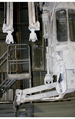

The crane’s pneumatic jackhammer breaks the crust that forms on top of smelting pots.
A hard crust forms on top of the pots during this process. This crust must be broken periodically so anodes made of carbon can be exchanged. These electrodes, through which positive electric charge flows, create the heat that melts the ore. These are consumed in the process and must be replaced with new elements on a periodic schedule.
A critical apparatus used to replace the anodes is a crane that functions as a crust breaker. The crane’s pneumatic jackhammer—raised and lowered by an air cylinder—is used to break the crust. Compressed air powers both the cylinder and jackhammer. Maneuvering them requires a solenoid-operated directional control valve.
