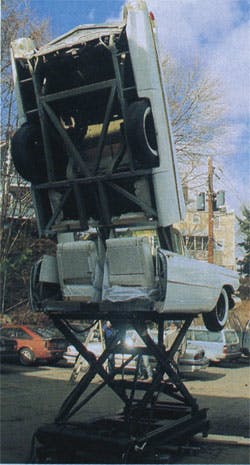

For example, in Miss Saigon, we made a Cadillac whose rear half could fold up to a vertical position because backstage room was so limited. As the Cadillac moved forward, the rear half would begin unfolding downward. We originally had only two limit switches for the motion — fully folded and fully unfolded. Later, we had to add an intermediate limit switch. Because the show’s main program was controlled by a PLC, a programmer had to search for the exact switch closure in the ladder logic program before the change could be added there.
