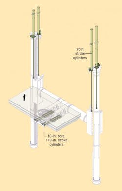

The 50 by 25 ft rectangular stage is mounted to a gantry that is lifted by four hydraulic cylinders along two columns that are 60 ft apart. The 12-in. bore, 70-ft stroke cylinders were manufactured by Parker Hannifin's Custom Cylinder Div., Eugene, Oreg. The original design called for longer stroke cylinders, but an industrial furnace large enough to harden the rods doesn't exist. Even at 70 ft, the 5-in. diameter rods had to be inserted diagonally to fit into the furnaces. Another challenge was transportation of the cylinders. There are very few tractor-trailer rigs that can transport a 75-ft cylinder. Special trusses were designed for cylinder protection during voyage from Eugene to Las Vegas. These cylinders, when totally extended, are almost as high as the Statue of Liberty and are the largest ever manufactured by Parker Hannifin.
The four vertically mounted cylinders require flow of almost 2200 gpm for the 2-ft/sec lift. This is accomplished by 10 Parker PE series piston pumps sized at 145 cc/rev and driven by five 250-hp motors. Each of the five pump sets produces 130 gpm. Significant dwell time occurs between stage moves, which allows charging accumulators with pressurized fluid. The balance of the flow required is supplied by a farm of 34 50-gal Parker accumulators and 17 350-gal pressurized nitrogen tanks (bottles).
The enormity of the structures being controlled becomes apparent in this drawing, which highlights the various cylinders used. Note how the structure dwarfs the 6-ft figure standing to the left.
The cylinders are mounted rod down above the stage gantry, and perform the lifting function while retracting. If the cylinders were mounted rod up, they would have to push the stage up. This would cause buckling of the 5-in. diameter, 70-ft. long rods. By mounting cylinders rod down, the rod is always in tension, eliminating the likelihood of buckling. Servo control manifolds are mounted to the rod ports of the cylinders. Each of the four cylinders is controlled independently by its own servovalve manifold. This valve concept utilizes a 3-way, 80mm proportional valves from Atos, York, Pa., and a Parker D3FH series zero-lap servo solenoid valve. The two valves work together to provide both the high flow and fine resolution required.
Oil is fed to the rod side of the cylinder only, the stage is lowered by metering out the oil in a closed-loop circuit from all four cylinders. The reason for not pressurizing the cap end of the cylinders is the fear of bending a cylinder rod, should an anomaly occur in the servo system. It could take only 500 psi on the cap end to bend and damage a 5-in. rod extended 70 ft, if the right conditions exist.

The stage is tilted with four Parker 10-in. bore, 110-in. stroke cylinders. The control manifold contains two D81FH Parker zerooverlap proportional valves, which pass about 80 gpm each during a full-speed tilt. The stage will tilt 100° in less than 40 sec. During one scene, the tilt will dump a beach set, sand and all, into the depths of the theatre. In another scene, the tilted stage becomes a battlefield of acrobats while images are projected onto it.
