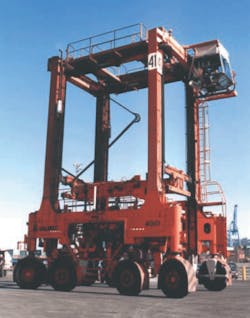

Port Authority officials then shifted their attention to 21 Valmet/Sisu straddle carriers. Average engine life before overhaul on these machines was 7200 operating hours, and their maximum life was 9000 hr. Engine oil was changed every 250 hr and had an average ISO cleanliness code of 19/16.

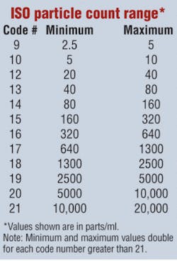

The target to extend engine and oil change intervals was determined be an ISO particle level of 15/12. We fitted the machines with new filtration systems, and the result was oil change intervals extended to 750 and 1000 hr.
Furthermore, such favorable performance and test reports prompted the Port of Tacoma to push the period between engine overhauls out to 21,000 hr. At the beginning of last year, the equipment's Volvo engines had reached 16,000 service hours and were expected to reach the 21,000-hr target set nearly six years ago. Some of the engines have lasted even longer. Officials attribute much of this success to maintaining particle counts at or below target levels. In fact, ISO levels of 14/11 and 13/10 now are common.
