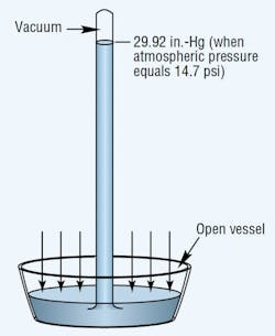

The maximum vacuum rating for a pump is commonly expressed for either continuous or intermittent duty cycles, and can be obtained from pump manufacturers. Because the maximum theoretical vacuum at sea level is 29.92 in.-Hg, actual pump capabilities are based on and compared to this theoretical value. Depending on pump design, the vacuum limit ranges from 28 to 29.5 in.-Hg or about 93% or 98% of the maximum theoretical value. For some pump types, the maximum vacuum rating will be based on this practical upper limit. For others, where heat dissipation is a problem, the maximum vacuum rating might also take into account allowable temperature rise.
