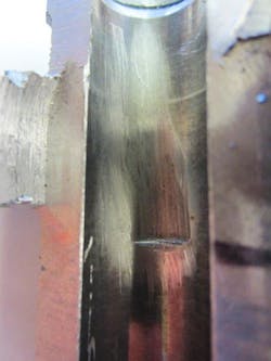

Samples 4 and 5 were subjected to side loading and did not have any design modifications to reduce side-loading damage. Consequently, both exhibited severe side-loading damage similar to that found on field returns. Figure 5 shows the bore damage to sample 4.

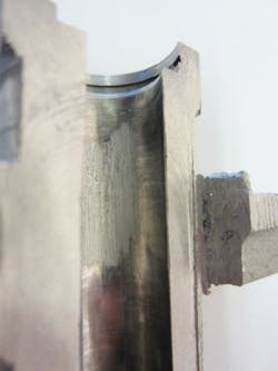

The significant bore wear is due to the push rod rubbing on the same area as a result of a repetitive side load. This damage causes aluminum grit from the bore wall to enter the system. Dimensional deformation causes the seal to not seal properly, resulting in brake fluid bypassing and leaking. Sample 5 exhibited similar damage.
Both samples showed that the action of the push rod wearing on the bore wall created the side-load damage. The steel push rod, significantly harder than the aluminum, made it the largest contributing factor to the wear observed.

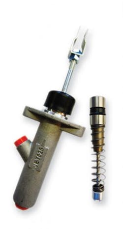

Side loading is the most common damage observed on master-cylinder field returns and can lead to premature product failure. In an effort to improve the master-cylinder product, several samples of existing and new designs were tested.
Under ideal conditions — particularly linear loading — the existing master-cylinder design is sufficient. However, subsequent testing under side loading revealed that the current design is susceptible to damage. We found that the major cause of side-loading damage is from the steel push rod wearing on the aluminum cylinder bore.
The wear patterns created in testing are quite similar to those observed on field returns. The design and testing of a nylon cap on the rod end showed that side-loading damage essentially can be eliminated. Implementing this solution will result in a superior product with a longer life.
