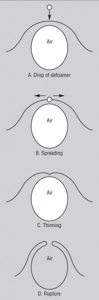

The only way to break this high surface area foam is to introduce a defoamant (i.e. a silicone) into the surface film that stabilizes the foam, Figure 4(A). The defoamant then spreads throughout the surface of the film, surrounding the air pockets, Figure 4(B). As the defoamant spreads, the shearing force causes a flow of the stabilizing film away from the gas bubble interface, resulting in a thinning of the interfacial film, Figure 4(C). This continues until the bubble ruptures, finally resulting in a release of the gas contained in the bubble, Figure 4(D).
