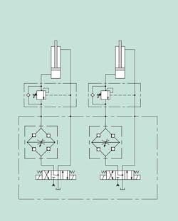

Solution to last month’s problem: Hydraulic system causes structural failure
Click on image for larger view.
The circuit design was intended to have the same speed lifting and lowering. The designer used a pressure and temperature-compensated flow control with 4-check valves arranged similar to an electrical “Diode bridge.” This always directed the oil flow coming from either direction through the flow control’s entry port. One of the checks failed open due to a contamination problem and allowed the oil to bypass the flow control and consequenty drop 60,000 pounds of steel coil 18” to a sudden stop.
