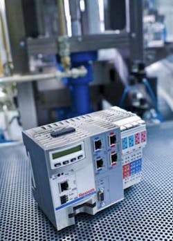

Many existing extrusion presses utilize limit switches or analog controls
to manage hydraulic cycles in the press. These legacy systems could be limiting productivity and adding to waste. Today’s state-of-the-art PLCs and closed-loop pump controllers provide much finer accuracy, whether operators are using press velocity or part temperature to manage extrusion throughput. An improved control system architecture provides greatly enhanced precision and automation of the hydraulics circuit, achieving much higher levels of position, velocity and endpoint control. These controls also allow adjustments during the extrusion cycle to keep production moving. Increased extrusion precision also leads to greater control over but length, helping reduce aluminum waste and increase the number of shapes produced per hour.

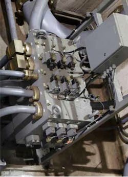

Hydraulic systems also can be simplified (and thus easier to operate and maintain) by replacing inline valve architectures with a single hydraulic manifold. This rationalizes the hydraulic design, reduces the leak points and hydraulic maintenance requirements and also can reduce the number of spare parts that must be stocked to keep the press operating.
