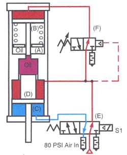

Figure 13-26 has a cutaway view of the intensifier cylinder at rest. (This view only shows function, not necessarily an actual assembly.) Air piston and rod C with attached hydraulic ram D move rapidly at low force to the work and return the tooling at the end of the cycle. Ram D is the area that intensified oil pushes on to get the short, high-force work stroke. Spring-loaded, floating piston A forms the top of a variable-volume, sealed oil tank. Spring-return air piston B drives its piston rod into trapped oil to intensify pressure for the work stroke. Directional control valve E cycles the advance and return strokes of cylinder C, and supplies air to pilot sequence valve F, starting the high-pressure work stroke.

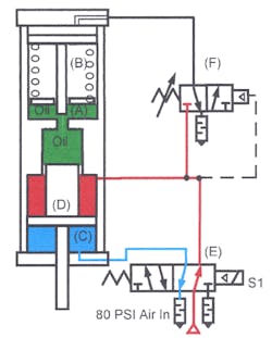

Fig 13-27
When directional valve Eshifts, as in Figure 13-27, air piston-and-rod C extends the tooling to the work rapidly. As the piston-and-rod extend, ram D advances and fills with oil from the variable-volume tank. Vacuum forms in the chamber behind ram D, and the spring behind the floating piston forces oil into the void. Piston-and-rod C continues to advance and oil transfers until the work is met. This low-force advance stroke moves quickly (and uses air flow controls when necessary). Seals on ram D separate oil and air.

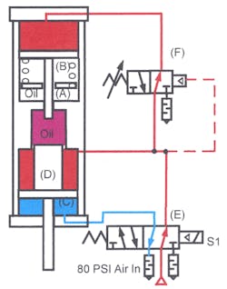

Fig 13-28
Figure 13-28 shows the intensifier after contacting the work. When air piston-and-rodC stop against the work, pressure build-up behind the piston shifts sequence valve F. When sequence valve F shifts, shop air extends spring-return air piston B. The first movement of the spring-loaded air piston advances the rod to the flow port connecting the tank to the chamber behind hydraulic ram D. As the rod enters this flow port, it passes through a resilient seal, stopping flow to tank and sealing the chamber behind ram D. This action automatically isolates the low-pressure chamber — eliminating the need for a pilot-operated check valve.
