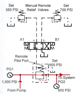

Remotely operating a pressure-reducing valve
Pilot-operated reducing valves have a remote pressure-control port. Connecting this port to other pressure valves allows pressure to be changed from a remote location. For example, Figure 16-12 shows a reducing valve with a directional valve and two remote relief valves connected to the remote-control port. With the directional control valve in its center position, set the pressure with the knob on the reducing valve. This setting is always the highest reduced pressure for the circuit.
Figure 16-12. Using remote pilot port for three different system pressures (no solenoids energized).
Energizing solenoid A1 of the directional valve, as in Figure 16-13, connects the remote pilot port to the remote relief valve SET 350 psi. Pressure in the system now drops to and holds at 350 psi. Energizing solenoid B1 of the directional valve, as in Figure 16-14, connects the remote pilot port to the remote relief valve SET 700 psi. Pressure in the system now rises to 700 psi and holds at that level.
Figure 16-13. Using remote pilot port for three different system pressures (solenoid A1 energized).
Figure 16-15 shows the reducing valve’s remote port connected to an infinitely variable electrically modulated relief valve. An electronically controlled relief valve changes the reduced pressure infinitely with a remote electrical controller.
