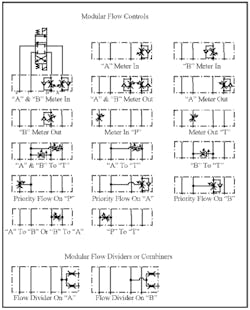

Figure 13-11 shows a pressure-compensated flow control in a meter-in circuit. Fluid from the valve enters the flow control and is restricted. Backpressure from restricted flow goes through the inlet-pressure pilot line and shifts the compensator spool to the right, restricting flow to the variable knife-edge orifice. Backpressure from cylinder resistance acts on the right end of the compensator spool through the outlet-pressure pilot line and adds to the 125-psi bias-spring force. This action and interaction always keeps pressure 125 psi higher at PG5 than at PG2. A constant pressure drop across the orifice maintains a constant flow to the cylinder.
Figure 13-12 shows a pressure-compensated flow control in a meter-out circuit. Fluid from the cylinder rod end enters the pressure-compensated flow control and is restricted at the variable knife-edge orifice. Backpressure through the inlet-pressure pilot line shifts the compensator spool to the right and restricts flow to the variable knife-edge orifice. Pressure at PG5 settles in at 125 psi and flow stays the same across the variable knife-edge orifice. Any backpressure from tank flow adds to the 125-psi bias-spring force and increases pressure at PG5 so it always stays 125 psi above PG4.

The fixed-volume pump and meter-in or meter-out flow control combination in Figure 13-13 is the worst-case situation. The example shows a cylinder stroking to the workpiece with flow controls set at 3 gpm. A 10-gpm pump driven by a 5-hp electric motor powers the circuit. Because it only takes 100 psi to move the cylinder while traversing, a lot of heat-generating energy is wasted. This example is somewhat exaggerated, but is not at all unheard of. Note the example only shows energy wasted on the extension stroke. With a reduced-speed retraction stroke, heat generation could almost double the figures shown.
The main generator of heat is the excess pump flow going across the relief valve at 1000 psi. The two circuits in Figure 13-14 show how to eliminate such wasted energy with a different flow control circuit or a different pump. While the energy wasted across the flow control valve is much less at these low flows, it still adds heat to a system. Also, the amount of pressure drop may be lower than indicated here because some actuators require more pressure to move them to and from the workpiece. Energy loss across a flow control cannot be eliminated. The amount of loss depends on pressure drop and flow rate across the orifice.
The circuits in Figure 13-14 show a fixed-volume pump with a bleed-off circuit and a pressure-compensated pump with a meter-in circuit. Both of these combinations save a lot of energy (although not as much as the load-sensing circuit that was shown in Figure 8-27). This type of flow control circuit wastes the least energy possible when using flow controls for speed control.
