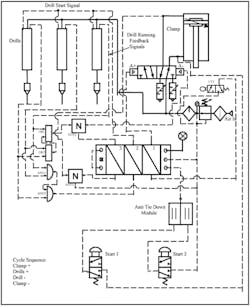

Example circuit
The drill circuit in Figure 19-12 uses most of the components discussed in this chapter -- plus other valves from other parts of this book. For safety, this circuit requires both of the operator's hands to be on the palm buttons simultaneously before a part can be clamped and drilled.
Fig. 19-12. Drill circuit with anti-tie-down start and anti-repeat
When the operator pushes Start 1 and Start 2 palm-button-operated, normally closed 3-way air valves, they send a signal to the AND1 and OR1 elements. One OR1 output goes to the N.C. time delay and it starts timing. At the same time, both signals from the palm-button valves satisfy AND1, so it sends a signal through NOT2 to the flip-flop to start the cycle. The output from NOT2 also goes to NOT1 and closes it. This keeps the N.C. time delay (which will time out in 0.5 to 1.0 sec) from sending a signal to block the start signal from AND1 to the flip-flop. When the flip-flop shifts, it sends a signal to A+ to start the clamp extending. The same signal also goes to LV1, where it is blocked. When the clamp reaches the part, it mechanically shifts LV1.
After the clamp cylinder extends fully, pressure in its rod end drops the inlet pressure to Start 1. If the operator still had the palm buttons depressed, the loss of air at Start 1 would be the same as releasing that button. Releasing either Start 1 or Start 2 causes AND1 to stop sending a signal to NOT2, which drops its signal to the flip-flop and to NOT1. When NOT1 loses its signal, the N.C. time delay sends a signal through NOT1 to close NOT2, thus preventing a later signal from the palm buttons through AND1 from giving another start signal. This same scenario also requires the operator to let up on both palm buttons anytime they are not depressed simultaneously within a 0.5- to 1.0-second delay. Now the anti-tie-down circuit also is anti-repeat.
LV1 sends a signal to start all three drills on their drill cycle. When the drills leave their home positions, they put out a signal that goes to AND2, AND3, OR2, and OR3. When AND2 and AND3 receive all three drill signals, they send a signal to the flip-flop that shifts it back to its home condition. Its output now goes to the inlet of NOT3. Any or all of the outputs of OR1 and OR2 hold NOT3 shut.
The three drills continue forward until they finish their operations. They then retract automatically (as commanded by their own internal valves). As each drill reaches home position, it drops its run signal to OR1 or OR2. When all drills have retracted fully, NOT3 opens and sends a signal to A- to unclamp the part.

Drill circuit using air logic controllers
The circuit in Figure 19-14 pictures another way of controlling the drills using air logic controllers and multi-function modules in place of all air logic modules. The machine functions the same as previously described, but there are fewer connections to make and less circuit design skills involved. For this circuit, some logic elements still were required because the drills' feedback is not from switches. A NOT element passes a signal when the clamp cylinder is retracted at the end of the cycle.
Fig. 19-14. Drill circuit with anti-tie-down start and anti-repeat using logic controllers
When the operator depresses the Start 1 and Start 2 palm buttons simultaneously, an output from the anti-tie-down module starts the first logic controller and it sends a signal to the clamp cylinder's directional control valve to extend the clamp. When the clamp fully extends and makes limit valve LV1, LV1 sends a signal back to the controller's first section which drops the clamp extend signal and starts the controllers second section.
Output from the second section of the controller starts the drills extending. As they begin to move, they send signals to two ANDS and two OR elements. After all drills start, the two AND elements send an output to the second controller, dropping the drill-start signal and starting the third controller.
Output from the third controller goes to the NOT2 element, which is being held shut by signals from the drills through any or all of the OR elements. When the last drill has fully retracted, the signal blocking NOT2 drops out and the third controller sends a signal to the clamp's directional control valve to retract it.
Air from the cap end of the clamp cylinder has been holding NOT1 closed and will do so until the clamp fully retracts and pressure drops in its cap end. When pressure drops in the clamp cylinder cap end, NOT1 opens and signals the third controller to drop its output and send a signal back to the first controller that the cycle is complete. (A limit valve could have been used in place of NOT1.)
