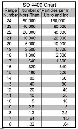

ISO has set up cleanliness level standards for hydraulic and lubrication fluids. The system most used for hydraulics is based on the ISO 4406 standard. This standard covers the number of particles of a given size that can be present in a fluid sample in three different micron ranges. It is designated ISO Code XXX/XXX/XXX, where the numbers relate to the minimum and maximum number of particles of a given size that can be present in a 100 milliliter sample. The first number indicates how many particles of 2-µ size can be present; the second number is for 5-µ particles; and the third number is for 15-µ particles. It might be written ISO Code 18/16/13. The numerals always descend in value from left to right. This code would mean that there could be between 1300 and 2500 particles of 2-µ size, 320 to 640 particles of 5-µ size, and 40 to 80 particles of 25 µ.
Figure 7-7 indicates that, even with good eyesight, people cannot see a particle smaller than 40µ. Thus it is impossible to look at a sample of fluid and determine whether it is clean. Of course, it is possible to tell it is contaminated when large particles are plainly visible in the sample.
The ISO 4406 chart shows the range number and the number of particles that it represents. From this chart it is easy to set up or pick out any ISO Code cleanliness level.
